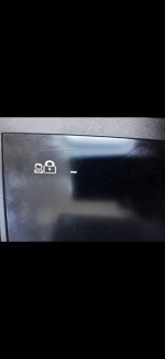

biltem teknoloji
my problem is removing bios password about it unlock bios is required
