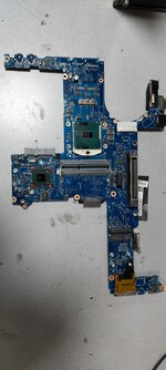

Hello.
I have BIOS Password and I want to remove BIOS password, the BIOS file is 8MB.
Best Regards.
  • HP EliteBook 8470p.Bin

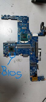

SAAFKOMDOOEL
Saaf
Thanks for your help.
I have many problems with this BIOS chip
1. I have Saved BIOS file with CH341A programmator.
2.The original file saved from the chip is 16.385KB (must be 16.384KB)
3.I try to write File you have send to me but there is error, Write is successful but verify is not.
4.I have try with EZ2019 programmator and RT809F programmator but I cant verify.
5.CH341A Programmator detect memory name: MX25L12845E
6.EZ2019 Programmator detect memory name : MX25L12805D
7.In chip MemoryName is writen thi : MX25L12845E
I have tried both of these settings but unsuccessfully
I think , maybe my programmator has not saved correctly the BIOS file.
Is there any solutions to send me another BIOS file.
